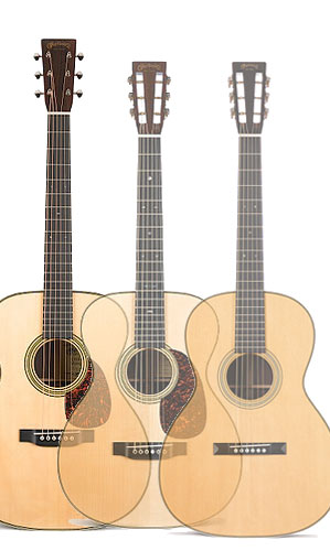

I posted this a few weeks ago. Might be useful.
From left to right: Martin OM-28V, 000-28 Norman Blake (12-fret, 24.9 scale on the 000 14-fret body), 000-28 12-fret. The body/neck joins are aligned, to show approximate relationships of bridge locations and body lengths, though the butt ends of the left two should really be even.
String spacing on the 14-fret 000 at bridge 2-1/8", neck width at nut 1-11/16"
String spacing on the OM at bridge 2-1/4", neck widthe at nut 1-3/4"
12-fret 000 is even wider, by another 1/16", IIRC.
OM seems better for fingerstyle, more space between strings at the nut and bridge.
